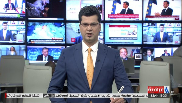

Name: "Iraqia News HD" Provider: "Nilesat"
11373, H, 27500 8PSK FEC 3/4
NetwordID: 318 TransponderID: 900 ServiceID: 534
Video: 5341(H.264) Audio: 5342 -
PCR: 5341 PMT: 5340 Teletext: 0

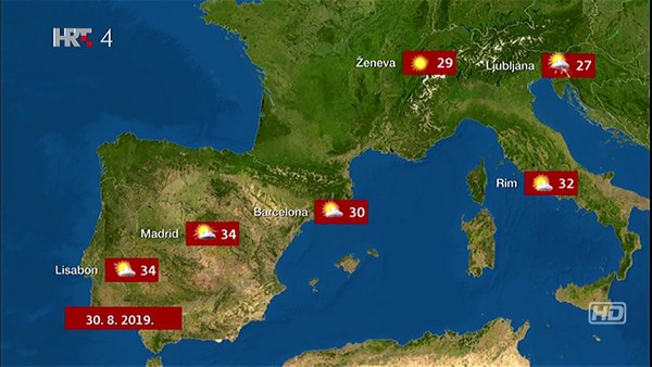

na de test uitzending op deze nieuwe transponder zijn nu de eerste  zenders  gestart.
het gaat om enkele HRT zenders die nu nog uitzenden via de 10.720 h  3/4 27.500
Name: "HRT-HR1" Provider: "OIV"
11636, V, 30000 8PSK FEC 2/3
NetwordID: 366 TransponderID: 51000 ServiceID: 3411
Video: 0 Audio: 212 - hrv
PCR: 212 PMT: 210 Teletext: 0
Name: "HRT-HR2" Provider: "OIV"
NetwordID: 366 TransponderID: 51000 ServiceID: 3412
Video: 0 Audio: 222 - hrv
PCR: 222 PMT: 220 Teletext: 0
Name: "HRT-HR3" Provider: "OIV"
NetwordID: 366 TransponderID: 51000 ServiceID: 3413
Video: 0 Audio: 232 - hrv
PCR: 232 PMT: 230 Teletext: 0
Name: "HRT-TV4 HD" Provider: "OIV"
NetwordID: 366 TransponderID: 51000 ServiceID: 3404
Video: 141(H.264) Audio: 142 - hrv
PCR: 141 PMT: 140 Teletext: 145
Name: "VOICE OF CRO" Provider: "OIV"
NetwordID: 366 TransponderID: 51000 ServiceID: 3414
Video: 0 Audio: 242 - hrv
PCR: 242 PMT: 240 Teletext: 0
